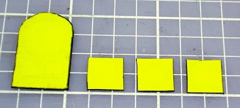

Make the Door and Window Frames
While you're waiting for the glue on the tower to dry, make the doors and windows. You can make all of them at once if you wish. However, the lighthouse doors and windows get a flourescent yellow insert before they're glued to the body of the lighthouse. The cottage doors and windows don't get "glazing" until after they are glued to the cottage walls.
Cut the doorframes and windowframes from thin cardboard or cardstock. Measure carefully and cut out with an edge guide and a sharp blade. A small pair of cuticle scissors may be helpful. The photo to the right shows the door and windowframes for the keeper's cottage after they have been cut out and painted.
Because your lighthouse cone may be a different size from mine, you may have to cut out several sets of doors and windows for that to get the best fit for your door and window openings.
- When you are satisfied, paint the frames your desired colors. Set the frames for the keeper's cabin aside.
- To give the impression of glowing windows on the lighthouse, glue flourescent yellow paper to the back of the lighthouse doors and windows. The photos below show the front and back of the lighthouse doors and windows after they've been "glazed" with yellor paper. Note that Howard has painted the outside edges all the way around to keep any yellow from showing where it shouldn't when they're mounted.
