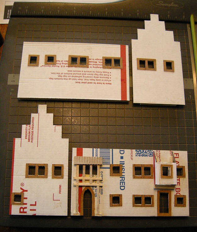

Puttering this weekend, found some time to start work on the top bit. Cut some window/door openings in the turret, which I'm making out of a cardboard shipping tube. I was going to try to cut a few arrowslits, but my cutting skills don't seem to be sharp enough (hahaha) to make a job of it. Set that aside for now. So then I started the fortified-house section...basically a copy of Howard's approach with a few minor changes:
Fortified house walls
HL project supplies l.jpg (182.11 KiB) Viewed 74817 times
Howard went with more windows, but I did away with the first-floor openings on the exposed sides (except for one which will be inside the castle wall). I added a bump-out on the front which the roof will carry down to cover (hopefully), but then I shamelessly copied Howard's timbered bit. I've got an idea how to add some interest to the wall areas where I deleted the openings.
I'm hoping the primer/paint I'm planning to use will cover the USPS printing on the old priority mailing box I used...if not, I'm hosed. I plan to go back and finish the turret before starting the keep. Then there's the walls and the gate. This project is alot of work...my hat's off to Howard for having the imagination/patience/skill to complete this.

Paul...
I've used recycled express boxes before on many projects...the primer always worked to cover printing...my favorite primers are as follows (in no particular order)...the best ultra white flat interior wall paint i can afford...gray color anti-skid floor paint...gray primer and flat black spray paint from Walmart...premium quality flat white spray paint (the budget brands of white don't seem to cover as well as the higher priced brands)...sometimes i apply two coats no matter what primer i use...
Your castle/tunnel is going to turn out just fine...don't fret...there are no rules as to what surface details you add or don't add...yes...the castle/tunnel is a lot of work...stick with it...
By the way...I "shamelessly copied" details of the vintage original castle/tunnel when I built mine...that's our little secret...

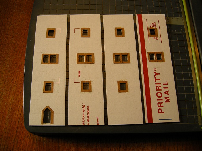

Made some progress on the keep walls yesterday:
Keep walls
Keep walls
HL project m.jpg (128.6 KiB) Viewed 74805 times
I think I'll need to complete the trim and paint the four sides before assembling, as once it's put together, I won't be able to get my hands/fingers up inside to glue in the window glazing. I can trim and paint the top after assembly, but anything that needs to go in from the inside will be a problem once assembled.

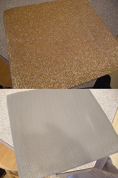

I went to Michael's this AM to track down a sheet of a finer grade of single-face corrugated...all they had was a few sheets painted with glitter. Fortunately, I had a can of spray primer-gray:
Single-face corrugated repainted
single face.jpg (149.8 KiB) Viewed 74805 times
I think I have all of the supplies I need now. I have a few sheets of acetate I can use for the glazing, but haven't figured out how best to draw mullions on it (or if I even need to).

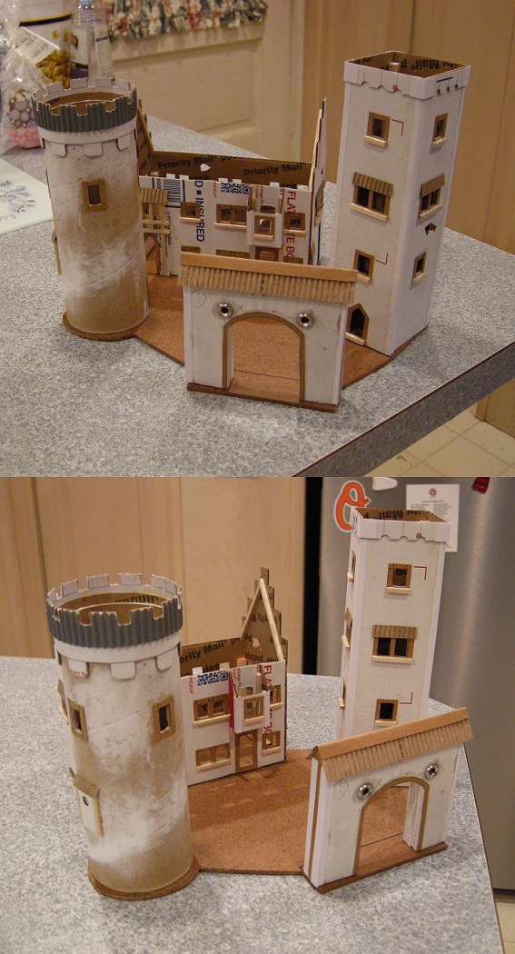

Making slow progress...got buried by another ten inches of snow earlier this week which needed to be dealt with.
The skeletons of the four primary sections are complete and I set them on the base just to see how they look proportionally. Each individually looks good, but they appear a bit crowded when arranged together:
Tunnel project arrangement
HL project n.jpg (244.22 KiB) Viewed 74772 times
The fortified house and the turret look a bit "compressed" for the base. When I up-scaled everything, it looks like I should have made the base a bit bigger. Can't change that now as it matches the footprint on the top of the mountain/tunnel bit. I dumbed the design of the gate down a bit from Howard's more ornate version; I had a bit of trouble building it up from layers of corrugated. Overall, I'm okay with everything as is, but it makes seeing the details on the front of the fortified house structure a bit difficult.
I'll probably start painting today. A coat of primer first, then a coat of textured paint (latex wall paint with a bit of model railroad ballast added). Haven't figured out what the final color will be, but probably fairly dark to approximate the Elastolin original. Still a bit of trim and a floor for the top of the keep, a floor for the top of the turret, and a roof for the house (which requires a few dormers).
I think I'm going to try making the windows on clear overhead transparency which I'll run through my inkjet printer in copy mode. We'll see how that goes.

Paul ll...
Three thumbs up!...just remember that these castles were made in quite a few models over the years...so there are no proportions to follow exactly...somewhere in my somewhat disorganized file of images I have photos of pages from a book about the history of these castles...I’ll see if I can find and send to you...

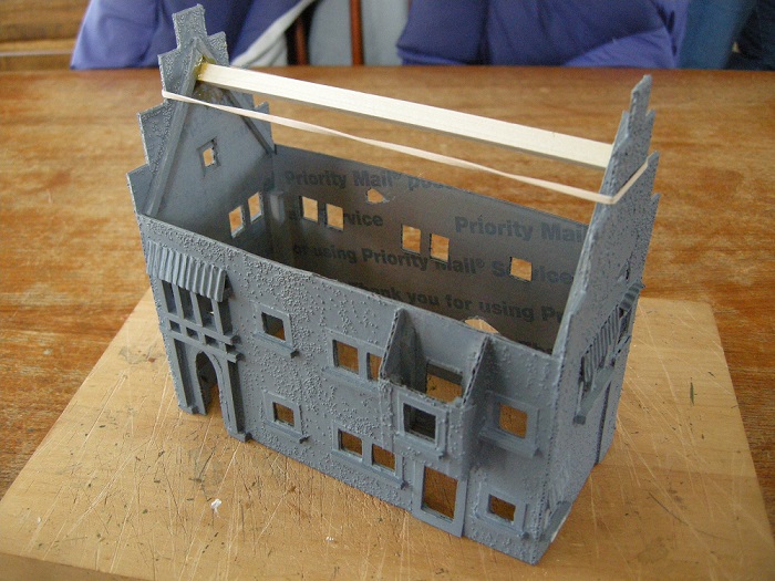

One thing I certainly need to fix...when I painted the fortified house, the end walls bowed out at the top. I'm going to try gluing a strut across the top to pull them in. Cementing the roof on would also likely fix the problem, but I want to have that a lift-off so I can insert a battery-powered light. A few things to sort out.

Thanks for the recommendations on adhesives, Howard. There are many good ones out there, some better than others (i.e. be wary of glues described as "all-purpose"). Sometimes you have to pick your glue based on the what and how you are gluing. For much of this project, I have returned to Titebond's original wood glue. It's similar to Elmer's All-Purpose but it get tackier faster and I think it bonds tighter and stronger. I've had good luck with the extra-strength glue-sticks when gluing up paper and card-stock. Not sure why it didn't work this time.
To try and straighten up the sides of the fortified house, I'm using Weldwood contact cement. Apply it, let it sit for fifteen minutes or so, than attach the bits and clamp it with a few rubber bands. I usually get a good strong bond with Weldwood, and this is going to require one. Cure time is probably 24 hours. The critical part of using Weldwood is making sure it's mixed...some of the bonding agent has a tendency to settle to the bottom of the can or jar, and mixing it can be difficult. If you don't get it mixed, however, the bond will be significantly weaker.
Fortified house straighten
HL project p.jpg (157.06 KiB) Viewed 74741 times
I tried using Gorilla glue when it first came out. It's a polyurthane-base, so you have to wet the surfaces of what you're gluing to get the best bond. I will admit, I tried using it on furniture construction/repairs, where stress can be amplified. It didn't seem to work very well, crystalizing over time and eventually coming apart. Plus the shelf-life is short...seemed bottles of the stuff went solid in a matter of weeks.
My current favorite glue is Loctite GO2. I've used it on everything - paper, wood, metal, cardboard, ceramics, and a few others, and it seems to hold up well. I haven't used it on any furniture or load-bearing joints. It's a bit of a mess to clean up, though, as it's not water-based.
When everything else fails, you're right, epoxy is the place to go, especially in the marine variation. That's the ultimate bond.
