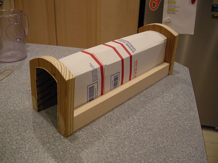

Thought I'd take a stab at Howard's castle-tunnel project, making a few changes along the way. Haven't gotten too far, but beginning with the tunnel underpinnings:
Castle-tunnel project
HL project a.jpg (153.44 KiB) Viewed 273808 times
Lengthened the tunnel by 4-5 inches, reduced the pitch of the portals, and modified the arch a bit. I also made it slightly narrower, but a half-inch taller. I plan to use a bit of foam-board in place of wood to cut down on weight. More to follow.

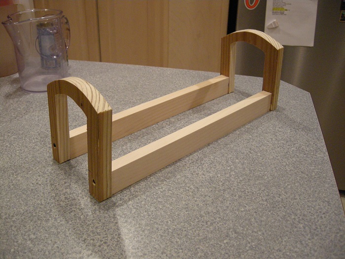

I got the liner fitted over the weekend, but it was a bear:
Tunnel liner
Tunnel liner
HL project b.jpg (152.25 KiB) Viewed 273797 times
I was going to use cereal box cardboard for the liner, but couldn't find any that was long enough (possibly the result of me lengthening the tunnel by 4-5 inches). Reverting to corrugated, I had difficulty getting it to take a graceful arch form. I used an old shipping tube as a sort of form, but the cardboard had a tendency to bend incrementally rather than in a nice curve. The ends look okay because they are glued to the form of the portals, but at the middle the ceiling is a bit notchy.
The other problem was I neglected to take into consideration the tilt at the top of each portal caused by the pitch they were cut on. When I glued in the liner at one end, a noticeable down-hill angle resulted. I had to force-fit the opposite end using a quite a bit of Titebond and a half-dozed C-clamps. The combination of the force-fit and the poor arching at the center resulted in a very slight hump. Twenty-four hours to dry, then I trimmed off the excess corrugated.
Presumably, the next step is to manufacture a couple of supports that sit over and atop the liner. These will hold the base of the structure that goes above. I'm thinking of using one-inch foam for these, but if that isn't strong enough, I'll use some scraps of one-by lumber. I've left the liner unattached to the side rails in case I need to do a bit of fiddling to get things to fit. When this bit is done, I'll glue the liner to the side rails.

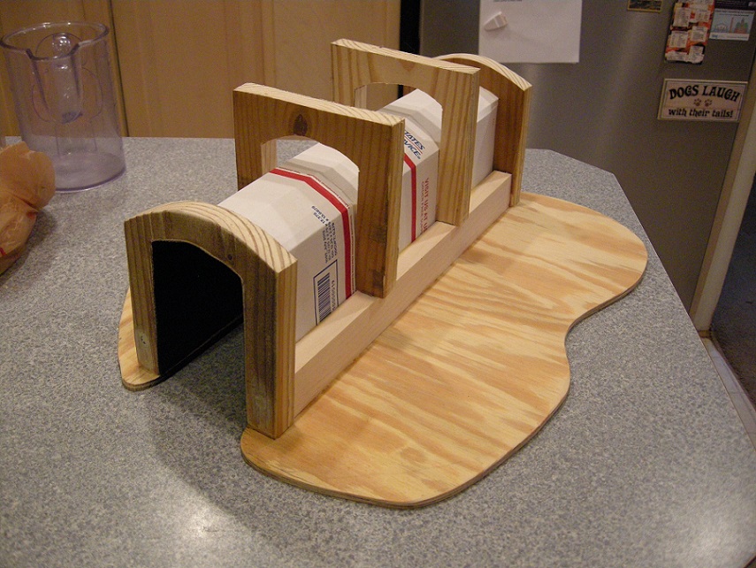

A bit more progress. I cut a couple of supports that I was going to fit snug to the tunnel liner and then build up, but then I decided I need more height for the plateau anyway, so I just glued them in and ran 2-1/2 inch screws up from the bottom. Unless I'm missing something, I think this should work.
More progress...
More progress...
HL project c.jpg (248.85 KiB) Viewed 273785 times
Since I lengthened the tunnel, I cut the base of the plateau a little bit bigger to try and keep the scale true to Howard's version, and I may flip it so it's position is opposite. I'll have to make that decision before I cut the base pieces for the tunnel.

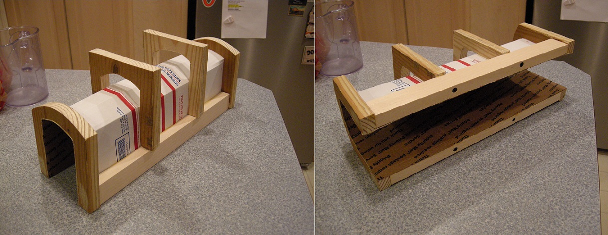

We continue. Cut the base(s) from a scrap sheet of 1/4-inch exterior-grade plywood, then affixed them with a bit of Titebond and a half-dozen cabinet screws.
Base attached
Base attached
HL project d.jpg (219.07 KiB) Viewed 273780 times
At this point, it's probably strong enough to stand on, lol.
Gave the tunnel liner a quick spray of satin black, and sanded the portals flush.
Next up, the "plateau". I have cut one, but I'm not sure it's large enough to keep the scale similar to Howard's. Might think on it for a few days.
