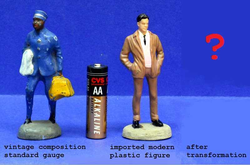

first...before christmas i traded for a vintage composition standard gauge figurine...not sure of the maker...(Trico?)...bottom is embossed "JAPAN"...i know these are way oversize...but i like them...even with marx tinplate...

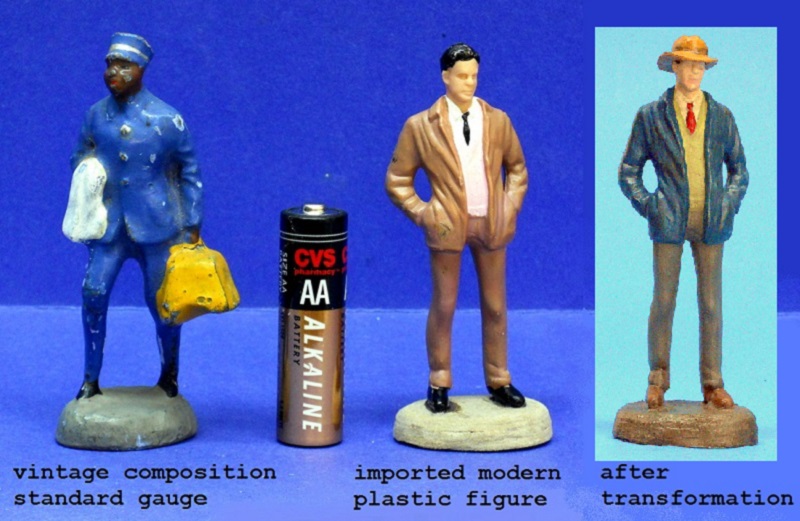

i'm taking a modern plastic figurine and sending him "back to the past"...i'll add a hat brim then prime, paint and detail to fit in with the other figurine...hope to make more or less a complete set...porter, conductor, engineer, fireman, passengers, etc...

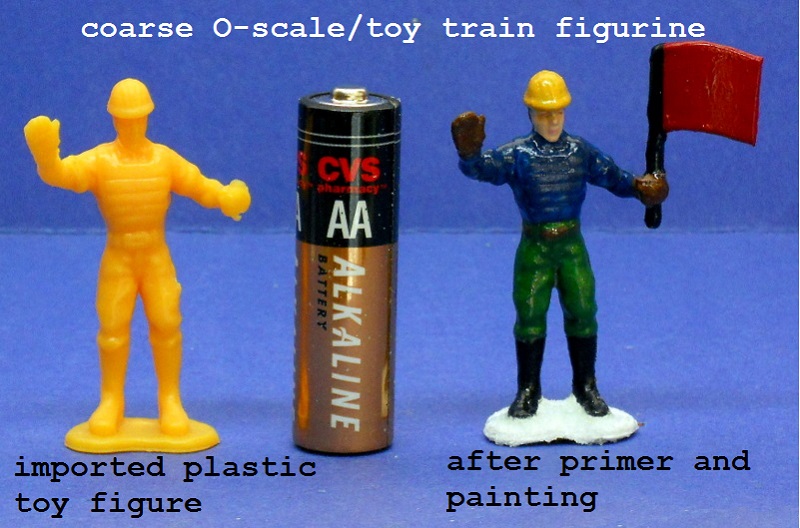

next...a simple transformation from imported plastic toy construction set figure to a coarse O-scale/toy train piece...just primer, craft paint and a semi-gloss finish...could be flat or dull coated...but in his final setting...which you'll see later...you'll see why...

- figurines-railroad-standard-and-coarse-O 001-001.JPG (149.76 KiB) Viewed 219869 times
- figurines-railroad-standard-and-coarse-O 006-001.JPG (154.06 KiB) Viewed 219869 times

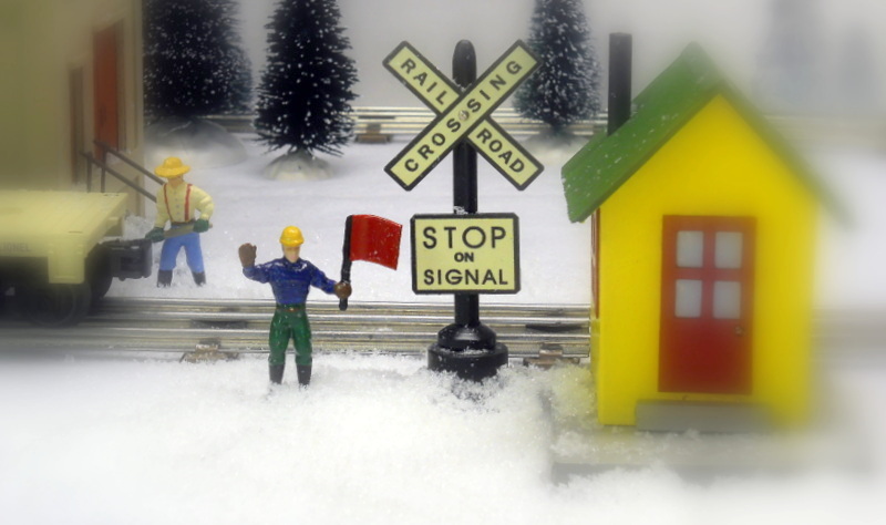

my crossing guard is finished...and ankle deep in snow on my tiny (30" x 48") "junction city yard" layout...
i have a few more construction figures from the same cheap, imported set that will get transformations...eventually...the one on the other side of the flatcar is from the same set...just added a hat brim and painted in the details...

- crossing-guard-bitf.JPG (96.92 KiB) Viewed 219850 times

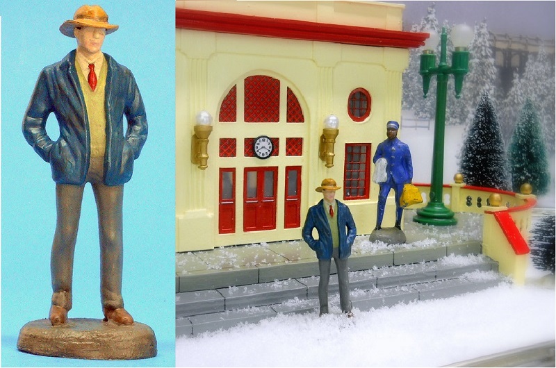

finished the (more or less) standard gauge figurine...learned a lot about wash shading after painting...went with a semi-gloss vs a dull-coat or flat finish...i think he will pass the "viewing distance" rule...

- standard-gauge-figure transformation-finished-bitf.JPG (177.67 KiB) Viewed 219826 times
- figurines-railroad-standard-vintage-plastic-after-bitf.jpg (145.19 KiB) Viewed 219827 times

He looks great...cool hat, has a 'Raiders of the Lost Ark" look about him. The semi-gloss finish has just the right bit of shine. Very nice...
